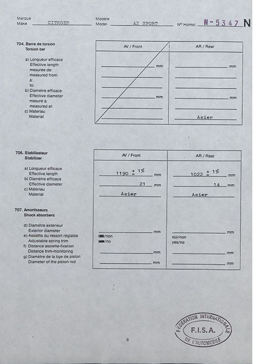

Hi,
Does anyone know why the rear anti roll bar on the AX sport is so thin? it is 14mm at the rear! :o Listed here on the homologation page:
I think the 205 rallye is 19.5mm on the rear.
I guess they just wanted the AX to be safe and 'under-steery' for the road!
Tim

205 rallye is very heavy ! :lol:
Light is right - AX Sport is hundred kilograms under 205 tank-rallye ^_^
